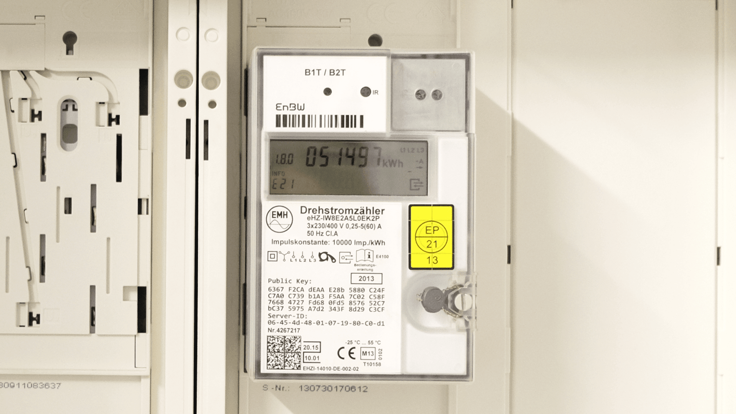

Where can I find the value 1.8.0 on the electricity meter?
On a digital electricity meter, the value 1.8.0 is displayed directly on the screen.
Often, the display automatically switches between different values.
Typically:
  • Display in alternating mode (every few seconds)
  • Identification on the left side of the display (e.g., "1.8.0")
  • next to it, the consumption value (e.g., 3,245 kWh)
If you don't see the value immediately:
  • press the button on the meter (if available)
  • or wait for the display to change
